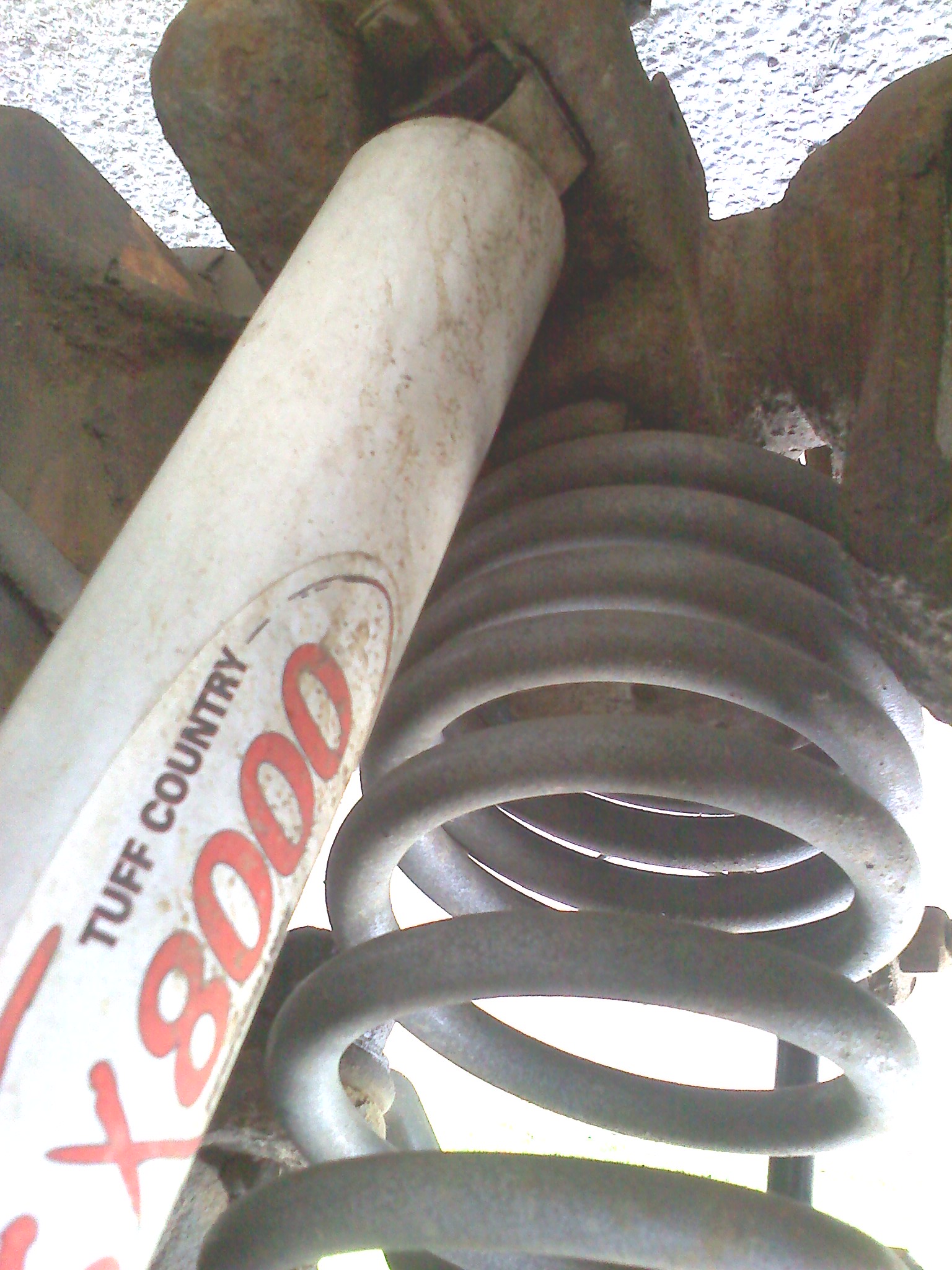

bump stop scraping?
The best way to do this is with the front diff hanging place 2 jackstands under frame behind the diff this will allow you to see the slightest play in the diff and whats causing it always best to have afreind around to help wiggle things around while the others looking for the problem spots
Check all your bushings uppers and lowers worn bushings will cause this inspect each and everyone carefully Look for oblong wear in any and all bushings worn bolts ect also check that the coils are seated correctly
Another thing I see after studying the pict again the coil is seated incorrectly see how the coils binding

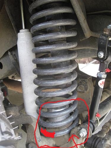

the coil end should sit like the red mark indicates in pict and coil to the rear

I think it's seated correctly.. I've also noticed that the sway bar is further to the driver side then the passenger side...

It drives fine, I have no problems, I just don't want to keep damaging the spring & bump stop... It also squeaks as they rub. But other than that, it tracks straight and i have no problem controlling it even in somewhat windy conditions.
