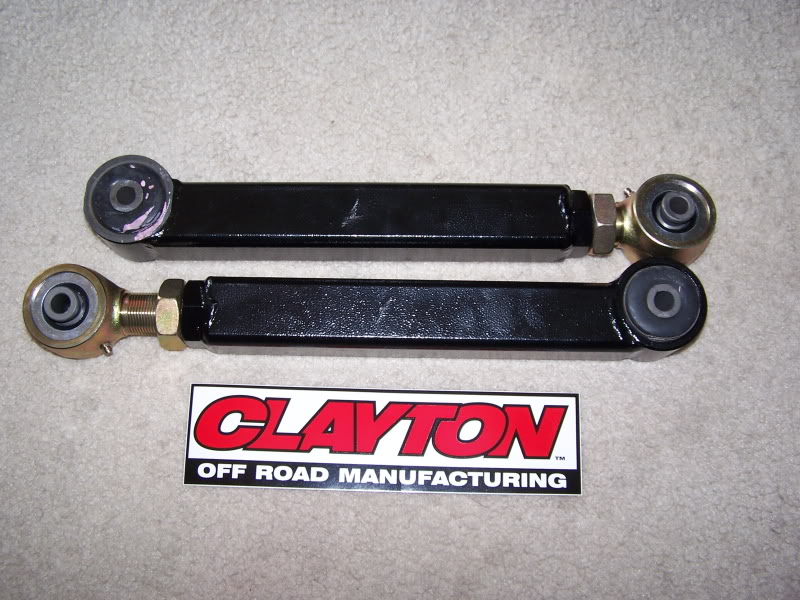

Checked out the bushing and they looked good. Stock uppers aren't that tuff and the bushings are looking a old and starting to wear down but they are hanging in there for now. Where is a good place to look for some adjustable front uppers for the future? Good quality but not going to break my bank.
should I get front adjustable uppers or lowers? I've got the factory front uppers and fixed heavy duty lowers currenty.
If your aftermarket lowers are 1"+ longer than stock I would get the adjustable uppers.
Keep in mind that when you get the uppers, it's a good idea to get 2 new bushings for the axle end of the uppers, they're pressed in the axle housing and not part of the control arms.

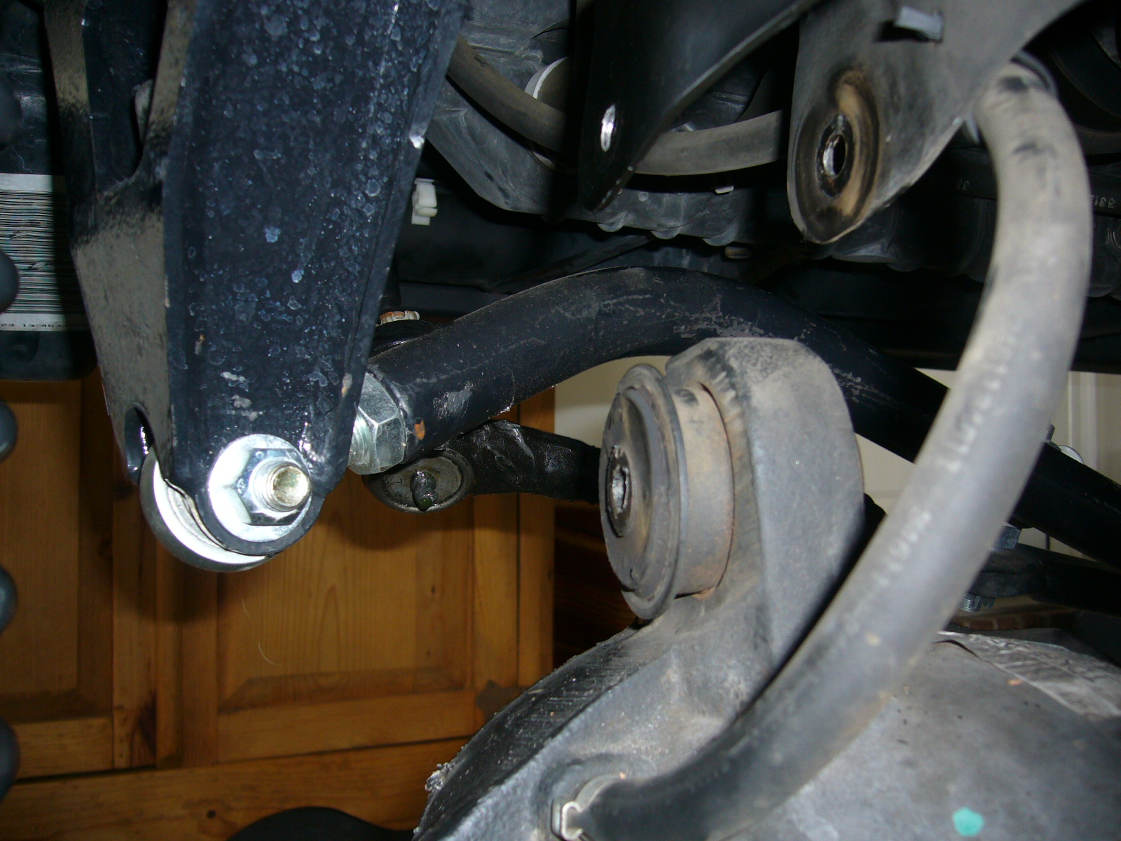

What is the secret on removing these bushings? Please don't say hit on it with a hammer.

Sorry, Hit it with a hammer!!. lol. Either use an air impact hammer or a chissel with a blunt edge and use a hammer and work around the bushing until it pops out.

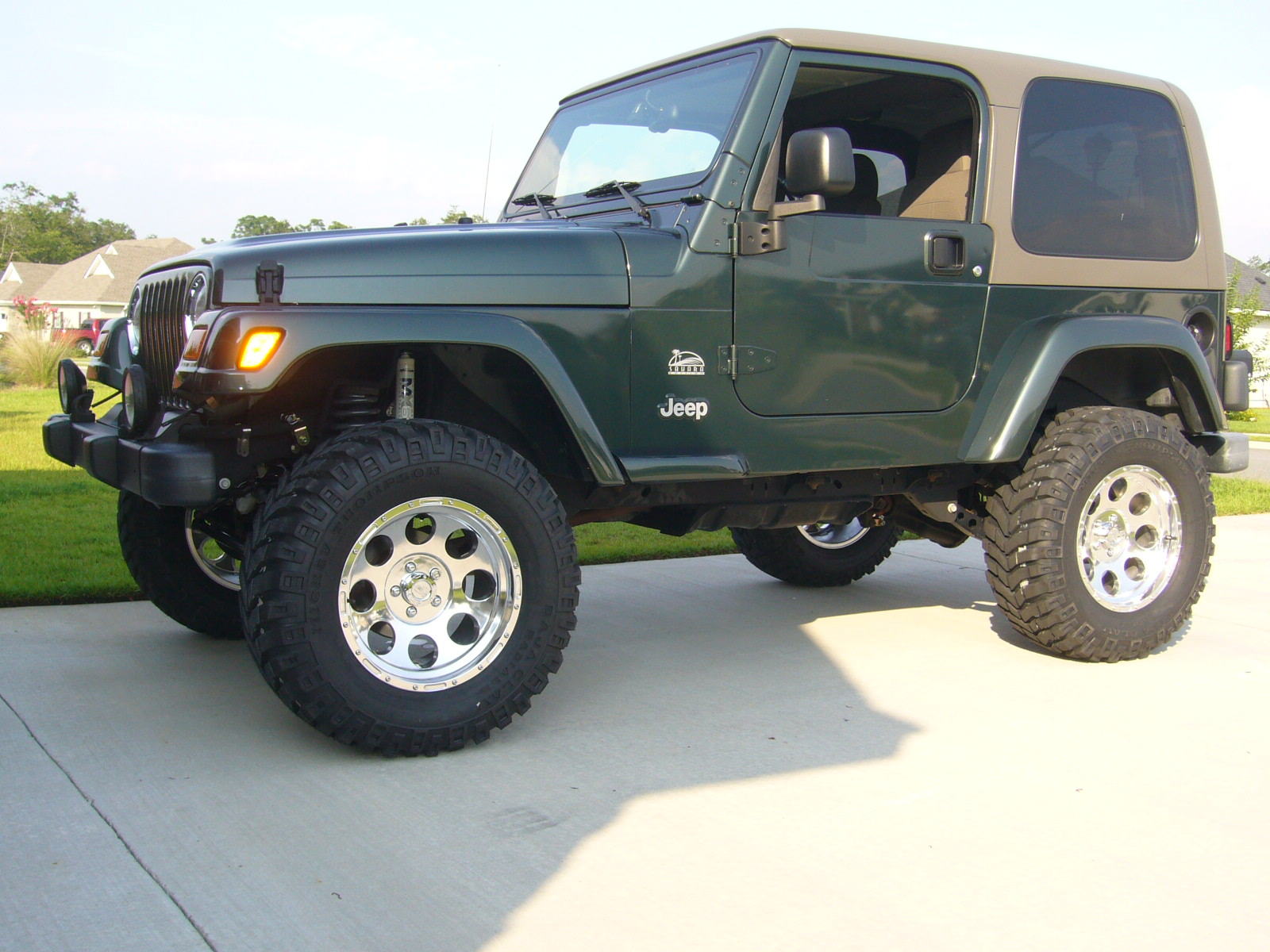

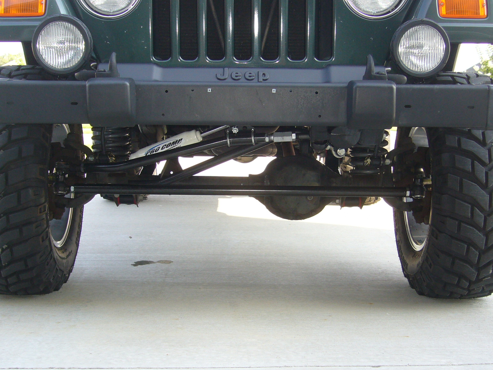

So, I've installed the ORO U-turn steering system and new wheels and tires. Here are some pictures. I like the ride the tires will take a little bit to get used to, lost some power, no dead spot in the steering between the 11-1 O'clock,. So far there is no Death Wooble but I've still got that stupid lean to the passenger side. The Coils on the passenger side are more compressed than the driverside. I'm not sure if my coils are weak or if this is normally what happens when they settle in. But I don't like it at all. I want to fix it and I'm not sure if I should get new coils or purchase that JKS ACOS kit. What do you think?

I would look at getting new springs, or if those are new, try to get them warrantied.
