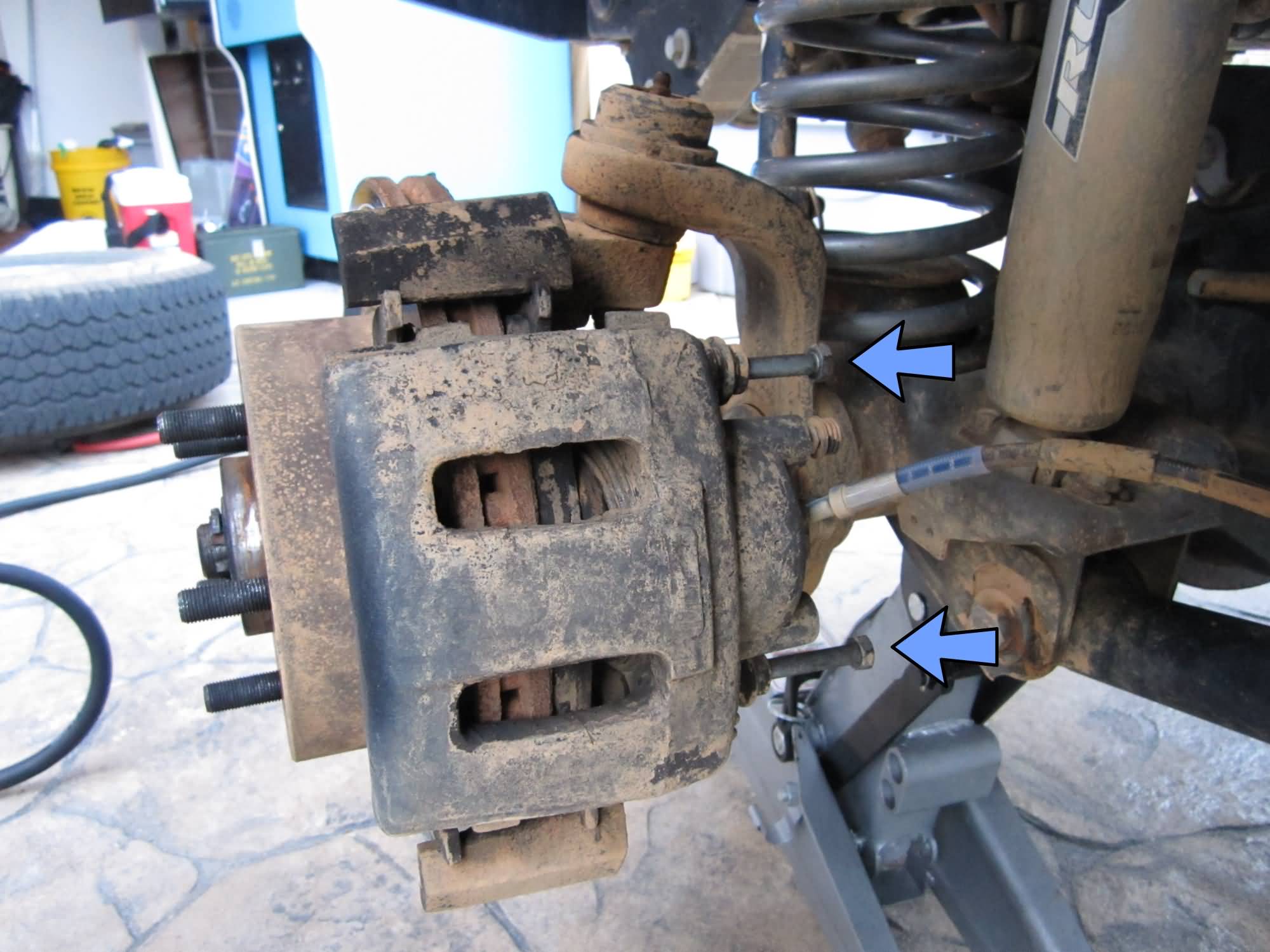

So, to get started, you'll need to remove your caliper bolts:

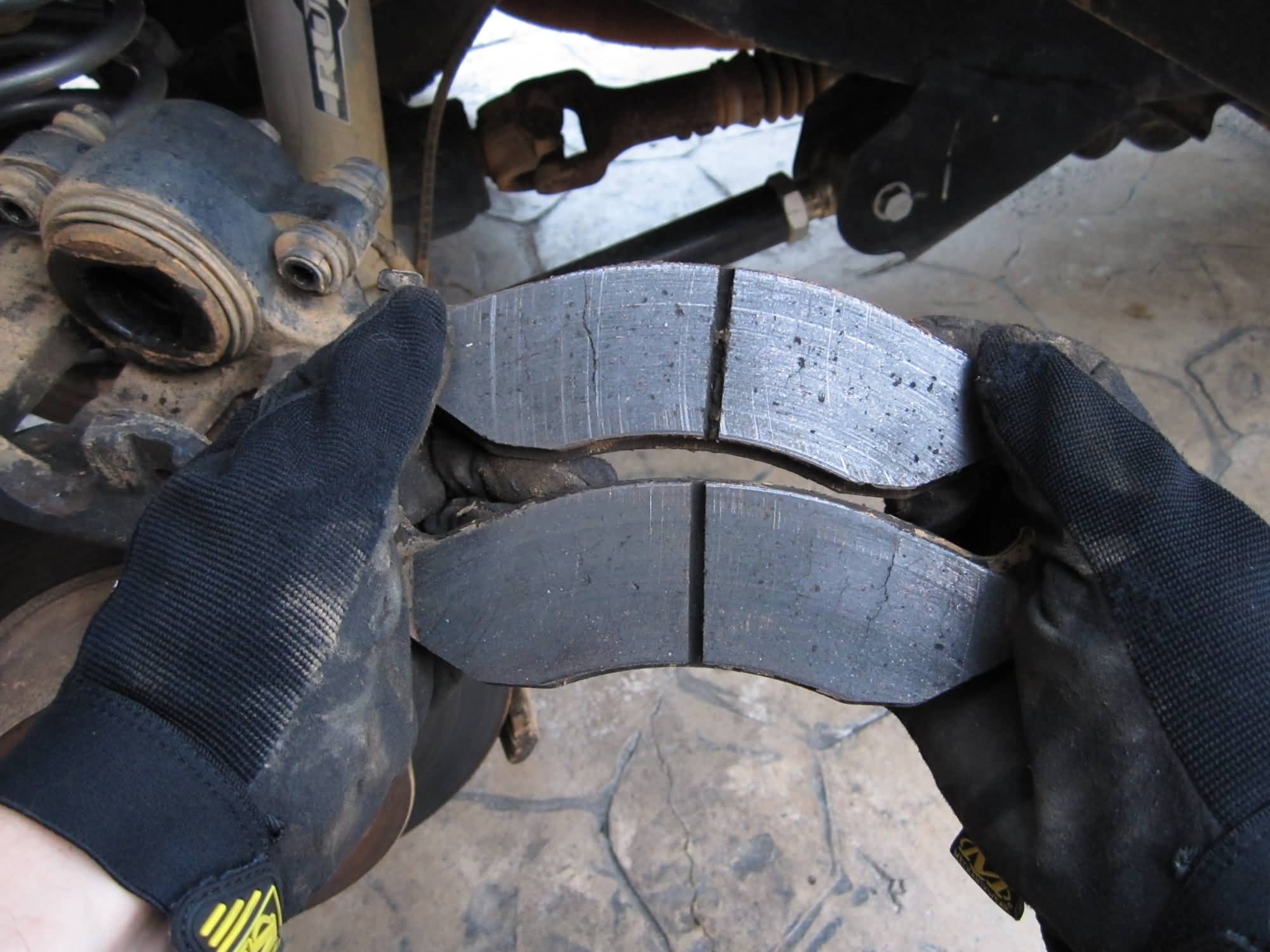

You can see below that the old pads have scores and cracks in them. This commonly comes from overheating.
![9_brake_pad_cracks.JPG 9_brake_pad_cracks.JPG](https://www.jeepz.com/forum/data/attachments/7/7078-80aa2cddd13467b9fd7c2d8798340e8e.jpg)

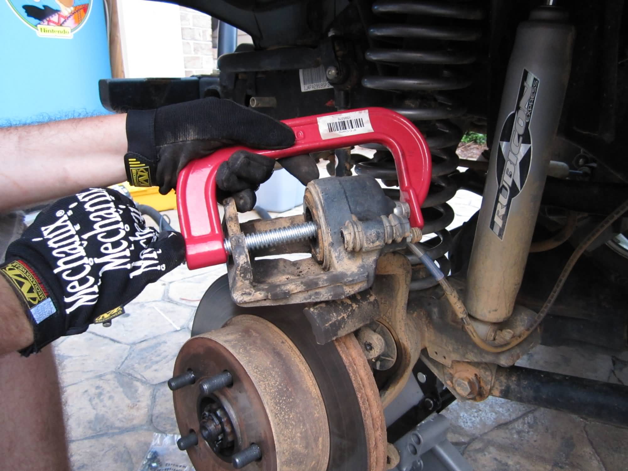

Now that are brake pads are out, we'll need to push the piston into the caliper slightly. You do this because the new brake pads will likely be larger than the old ones (the old ones had some of their material worn away. This is easily done with a large C clamp. Just position it like below and tighten down until the piston is flush with the caliper.
![10_compressing_the_piston.JPG 10_compressing_the_piston.JPG](https://www.jeepz.com/forum/data/attachments/7/7079-0747ad154f5ac867a747923b8de8cae7.jpg)

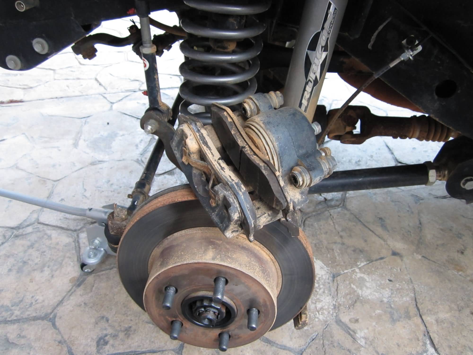

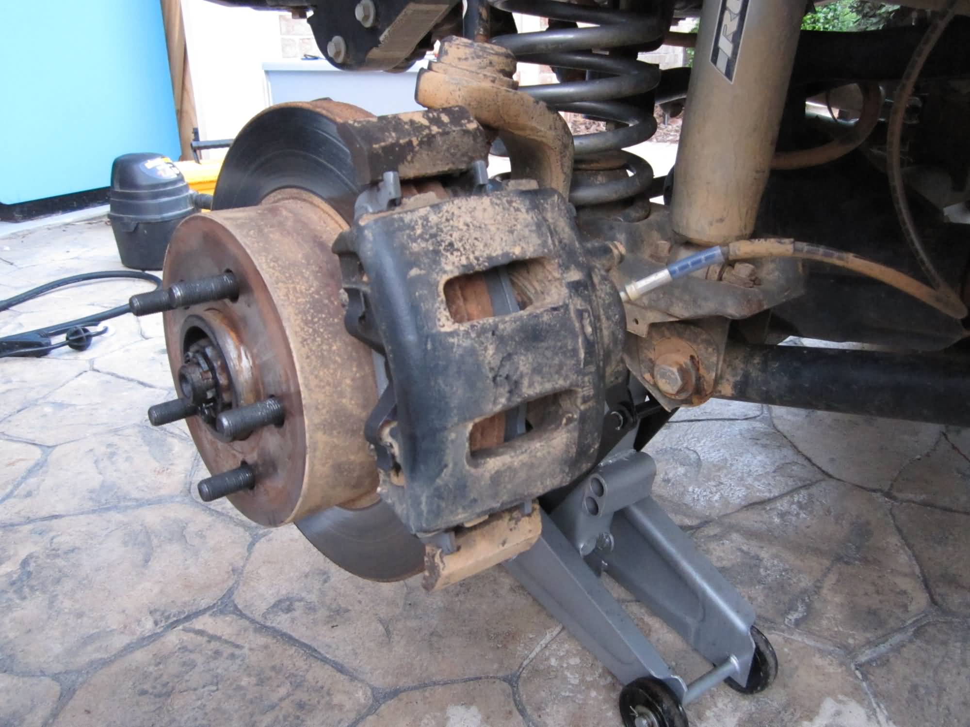

You'll see the following parts when you looks at your brakes – A rotor that spins around when the wheel turns, and a Caliper that holds your brake pads inside, and squeezes, or clamps down on the rotor when you press the brakes.
![1_wrangler_front_disc_brakes.JPG 1_wrangler_front_disc_brakes.JPG](https://www.jeepz.com/forum/data/attachments/7/7070-205d229440c678cdf5859d055b87043d.jpg)

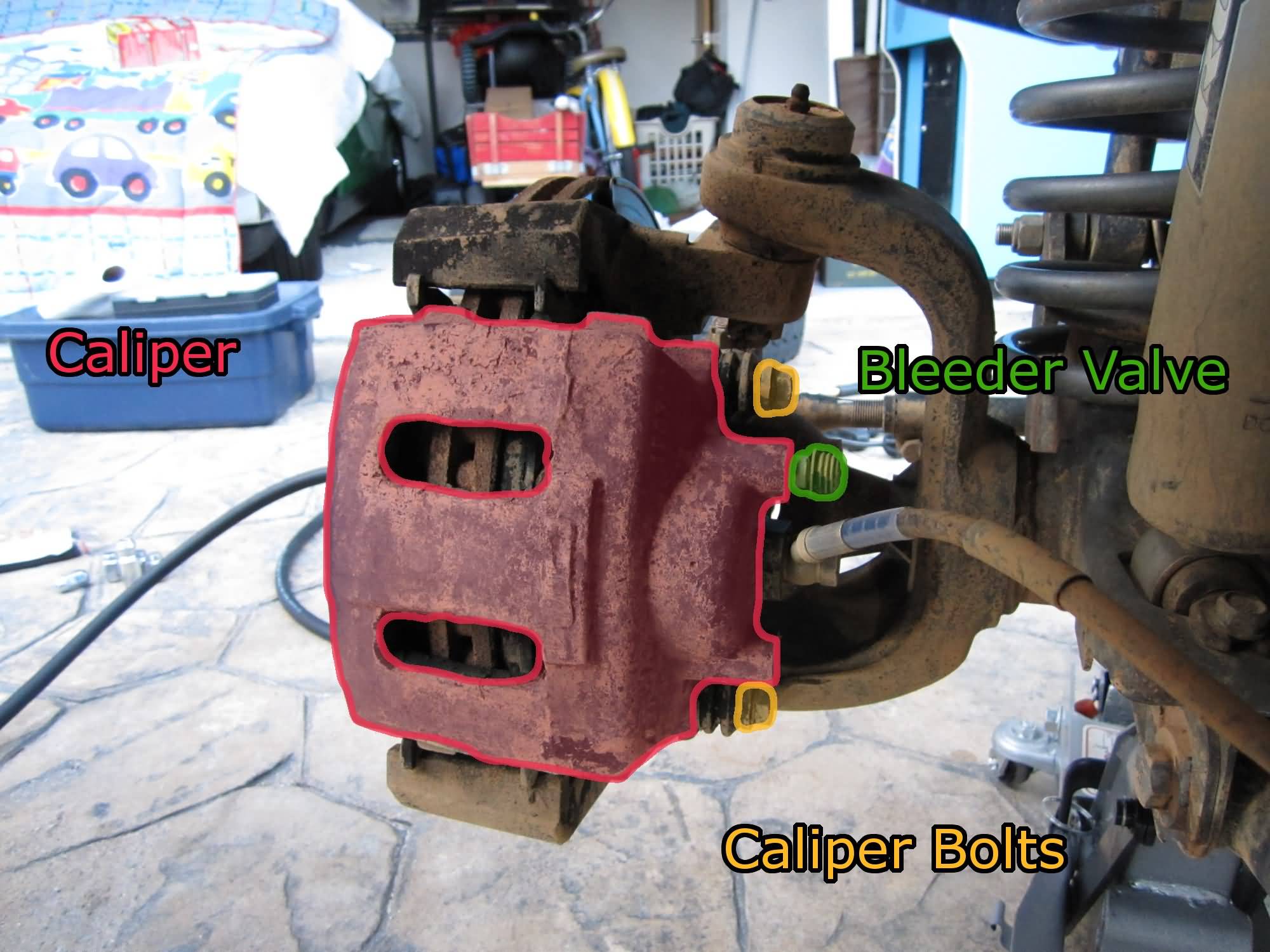

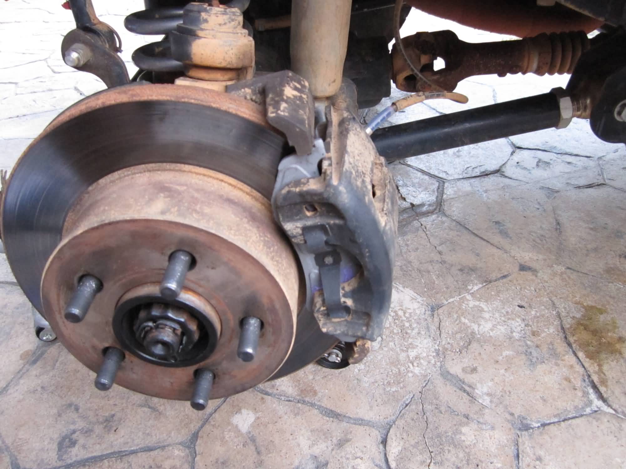

Looking from the back, you can see the various components of the brake caliper. The caliper bolts hold the caliper to your Jeep, and the bleeder valve (when loosened) will allow brake fluid out of the brake system.
![2_components_of_jeep_brakes.JPG 2_components_of_jeep_brakes.JPG](https://www.jeepz.com/forum/data/attachments/7/7071-9dc5e6e70e42e6717164fe86483d7d74.jpg)

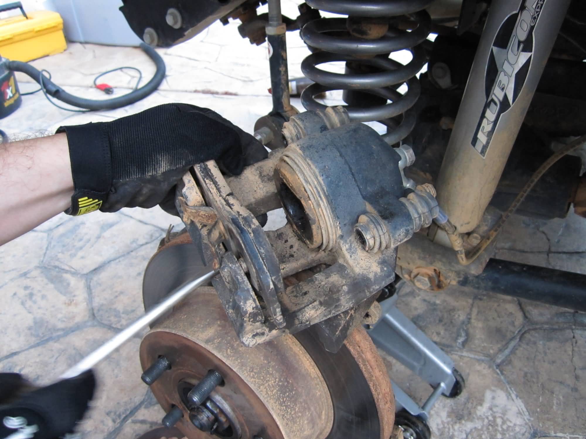

![4_caliper_bolts_removed.JPG 4_caliper_bolts_removed.JPG](https://www.jeepz.com/forum/data/attachments/7/7073-f18497349603b7e537ec4f26199d372a.jpg)
![3_remove_caliper_bolts.JPG 3_remove_caliper_bolts.JPG](https://www.jeepz.com/forum/data/attachments/7/7072-d8dd5f2a43770889070c17ed0c522dd2.jpg)

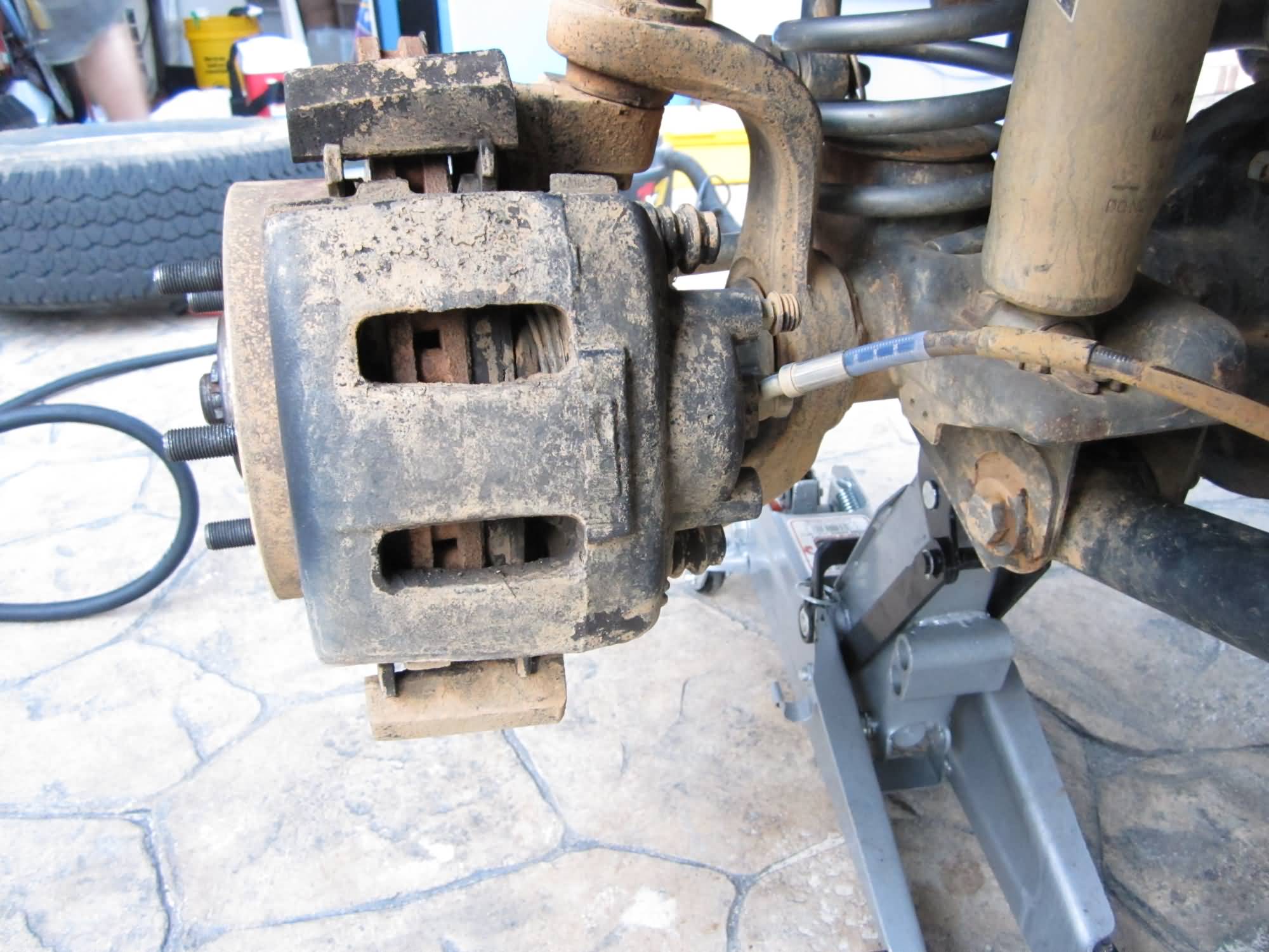

Now that the caliper bolts are out, you should be able to remove the caliper. Try to pull the caliper towards the rear of the Jeep. If the caliper doesn't come off, you can use a screwdriver to gently pry the caliper off (you shouldn't have to use much force though).
![5_remove caliper.JPG 5_remove caliper.JPG](https://www.jeepz.com/forum/data/attachments/7/7074-5652cbfb237fbd55a95dcfe0f3597a66.jpg)

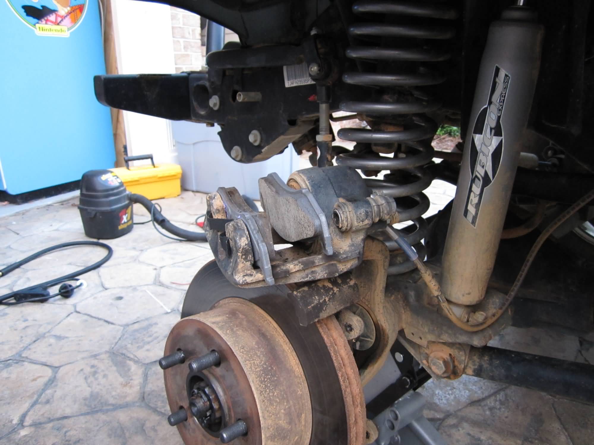

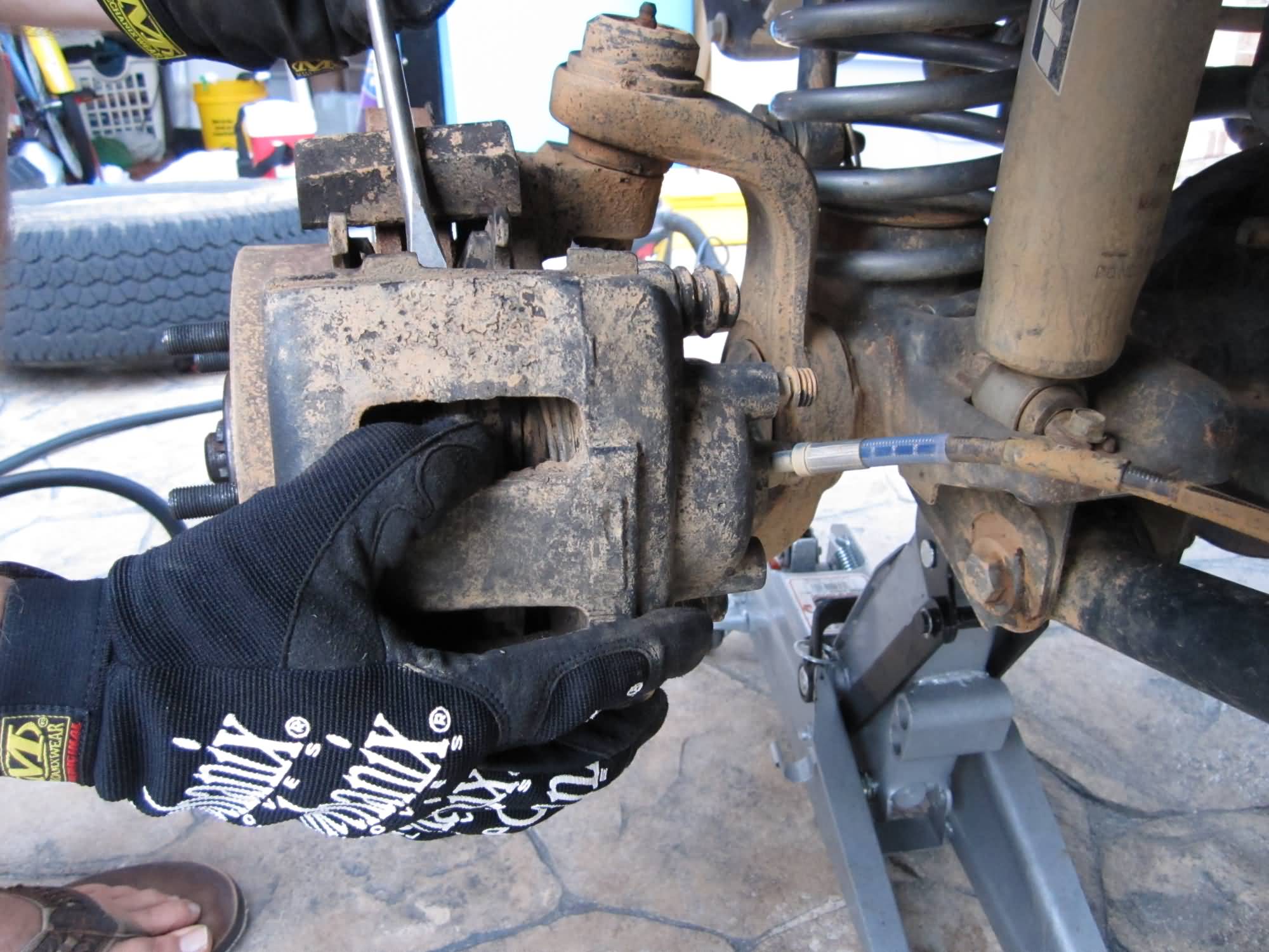

The Caliper will come off, but remain connected to the brake hose. I usually sit the caliper on top of the rotor, but you could also sit it on a stool inside the wheel well. Once the caliper is off DO NOT step on the brake pedal while they are being serviced as the piston may completely pop out and damage the piston seal.
![6_caliper_is_off_the_jeep.JPG 6_caliper_is_off_the_jeep.JPG](https://www.jeepz.com/forum/data/attachments/7/7075-5c8660ef1f0da7676fc49dbd1ce36261.jpg)

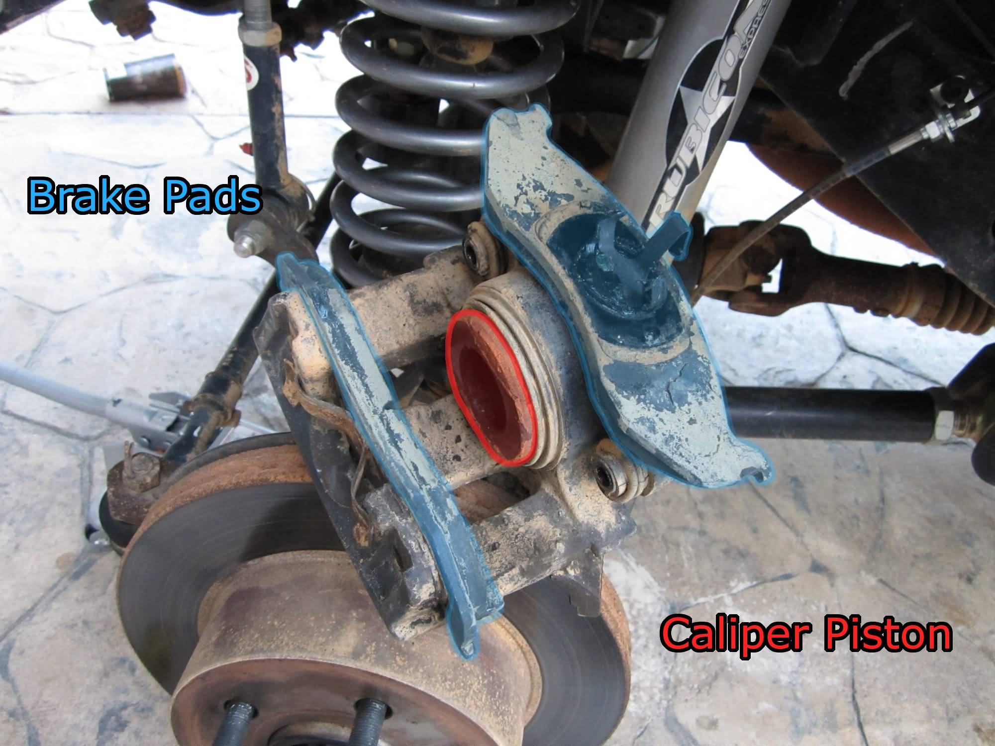

You can see below the two pads as well as the piston. When you press the brake pedal in your Jeep, the piston moves out, forcing the two brake pads to squeeze the rotor, stopping your Jeep.
![7_wrangler_caliper_parts.JPG 7_wrangler_caliper_parts.JPG](https://www.jeepz.com/forum/data/attachments/7/7076-92f3678cf3cb2a5d9aaa0021f64846ef.jpg)

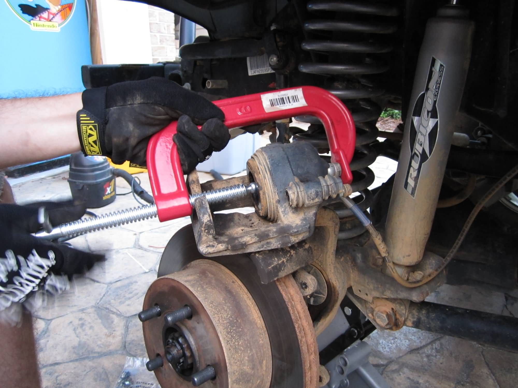

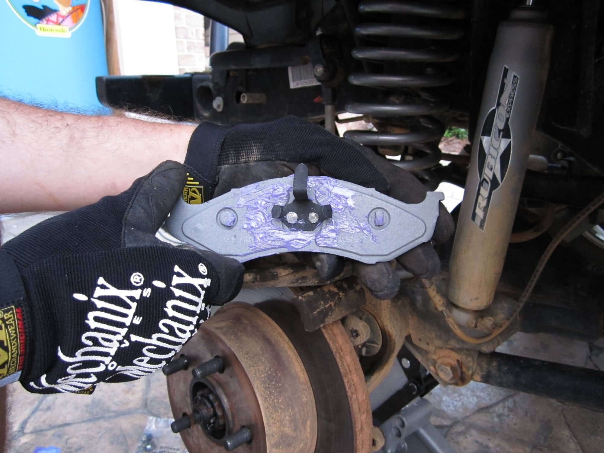

Optional - I decided to use some disc brake quiet. Just spread it evenly on back of the pad before reassembling. It is supposed to quiet squeaks - I didn't have any squeaks after installing the pads, but who knows if that's because of the disc brake quiet or not.
![13_disc_brake_quiet.JPG 13_disc_brake_quiet.JPG](https://www.jeepz.com/forum/data/attachments/7/7082-e597ffc1cd2c3d9bef63a659d7f84eac.jpg)

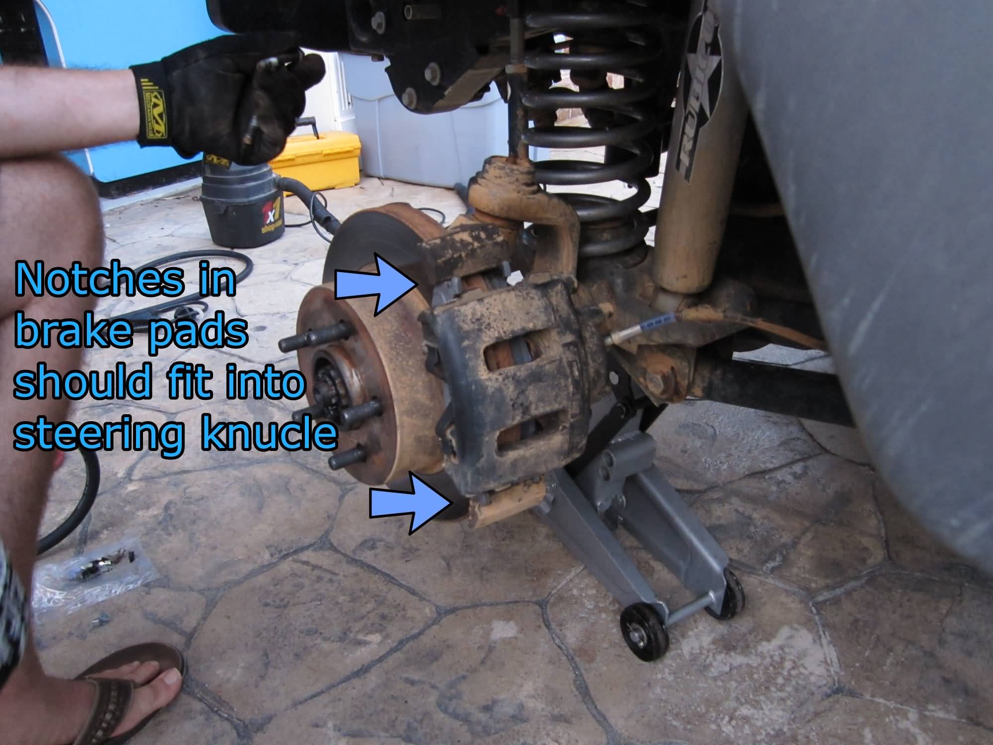

Now you'll need to reinstall the caliper on the rotor. There are notches on the brake pads that fit on the caliper slides (part of the steering knuckles). Before putting the caliper back on, wire brush the caliper bracket slides to ensure a smooth and proper brake pad engagement. After that, fit the top of the caliper in first, then the bottom.
![15_seat_the_caliper.JPG 15_seat_the_caliper.JPG](https://www.jeepz.com/forum/data/attachments/7/7084-340a2bb70babf193236bbdbe8082303f.jpg)
