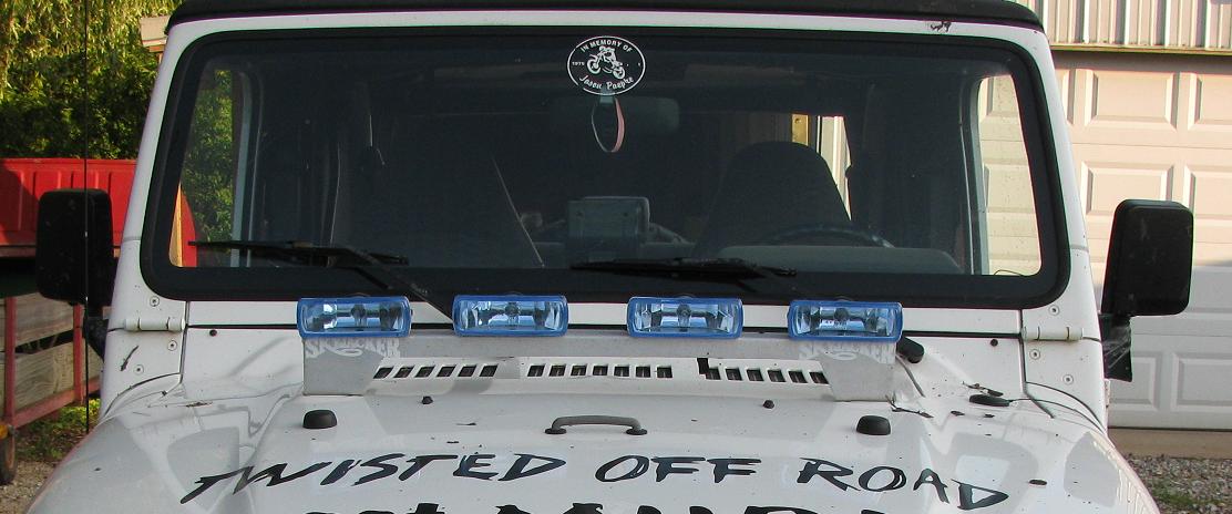

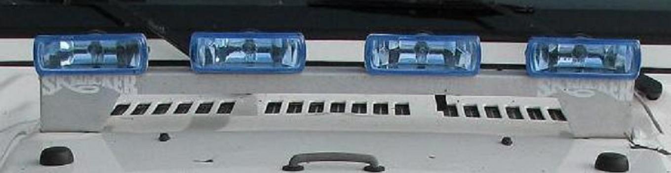

I made my owe hood light bar and thought i would get pulled over it is a little hi but its been a year and im doing good..but if you are looking to get one make it yourself. it cost me $30 for the lights the aluminum i had sitting around cut and bent had to make a little taller for the squirters but i realy like it...NOTE NOT FOR NIGHT TIME USE thay shine off the hood and reflect on the windshild.......can be used for DRL:lol:

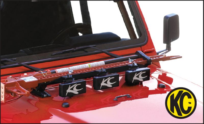

These are mounted on the hood hinges, right? Could not quite see it on the pic (not much contrast). I have a set of daylighters on hood hinges, and they DO reflect of the hood quite a bit (still, I use them at night, as they do light up the road ahead!). I used to have them on the windshield hinges, and they reflected FAAAAAAR less off the hood, but because of clearance issues with the snorkel, I had to relocate them. I just wish the YJ snorkel was like the TJ, where you can keep the windshield hinge mount!
What kind of lights are those? I bought a pair of lights that look exactly like those to go on my Eclipse when I still had it. They were like $20 at the auto parts store. They made the road easier to see but one of them went out within a month. After that I just removed them.
I don't remember the name but i picked them up a meijer $30 for 4 of them
i will look for the name.. and thay do work realy good i have them set up on a 3 way switch up is the middle 2 and down all 4 come on.
If you fabed up a piece of metal under them and paint it flat black it should stop some of the glare.It would also depend if they are long range or short range lights.Any type of mounting like that you should use long range beams.
well thanks but i like as is.. but im trying to let people know what the lights do.... and if they like it make ur own.... don't buy a $215 LIKE THIS and be disappointed
Nice job, not my thing.. All I fore see is hood glare being a *****.
I'll tell you this from my experience; when doing highway driving at night, I prefer to have the lights on even with the glare than off, as visibility down the road SIGNIFICANTLY increases (at least in my case). Now, mine are high-beams spot loghts, which means the glare is just the reflection of the light, as the spot is focused to the front (this would probably change if I put my fog lights up top), and I did prefer them when they were mounted on the windshield hinges, as glare was much less than now, but even now, I find the a plus for nightime driving (not particularly crazy on how they look on the hood, but I ran out of space!).
