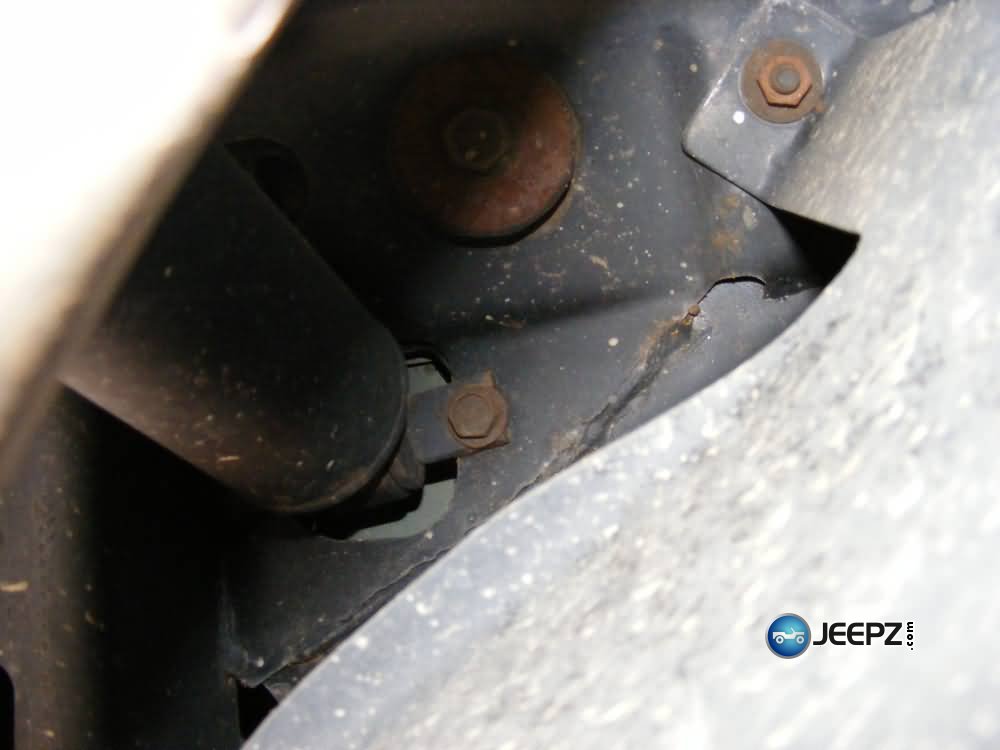

He's talking about the rear shocks, and I'm assuming he means the top bolt - those things are pretty tight up there.
I know what he is talkin about , i had to do 2 on mine . Just drill it out and re-tap . Not hard to do and will cost less than 10 bucks. If he wants to pay for it more power to him. I just hate paying people to do something i can do myself.

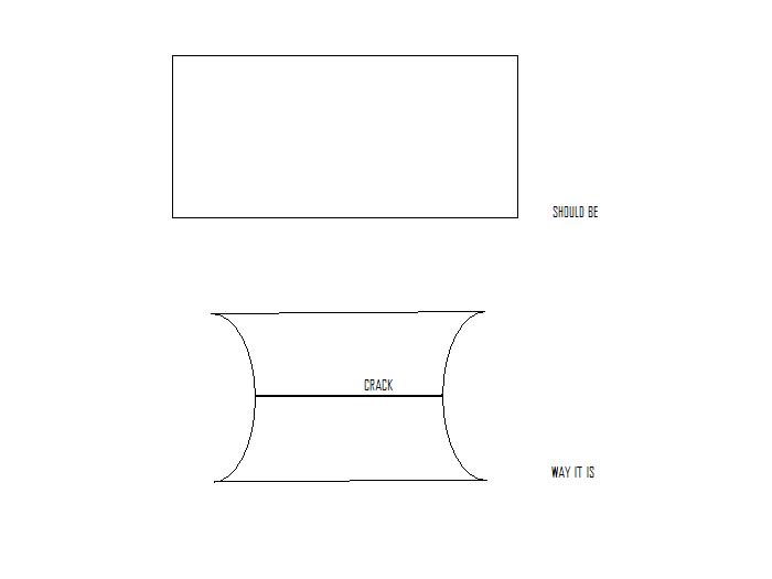

The reason I'm changing it is because it's really rusty and chipping off. On both the passenger and driver side of the truck, the skid plate is missing a lot of material, and there's a big crack right down the center. 10 years of upstate New York winters will do that to ya. I made a picture that showed it at the bottom.
