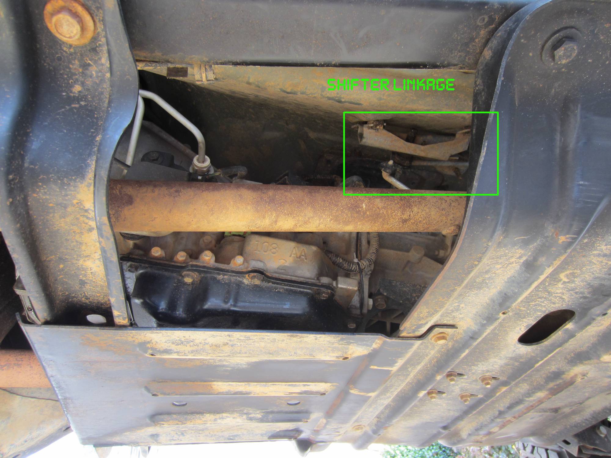

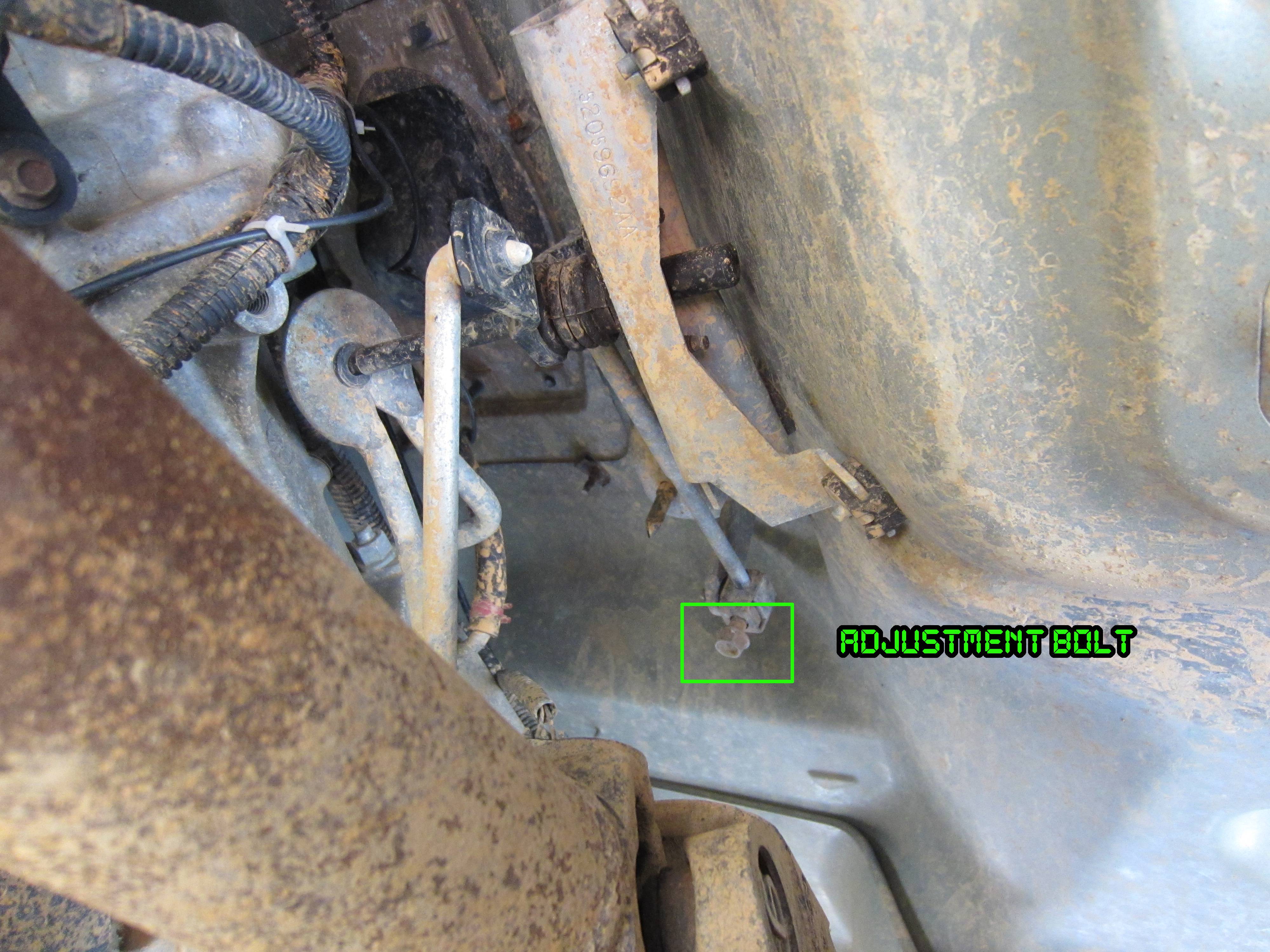

Assuming the bracket has been installed, you may just need to adjust it. There should be an adjustment bolt on the linkage - loosen that bolt, then manually put it in 4 low (you just push the rod all the way towards the front of the Jeep. Climb in your Jeep (with engine off) and put the shifter in 4 low (pull all the way back). Now, crawl back under your Jeep and tighten the adjustment bolt.
(this is on my 2005 auto, but I believe yours is similar).
