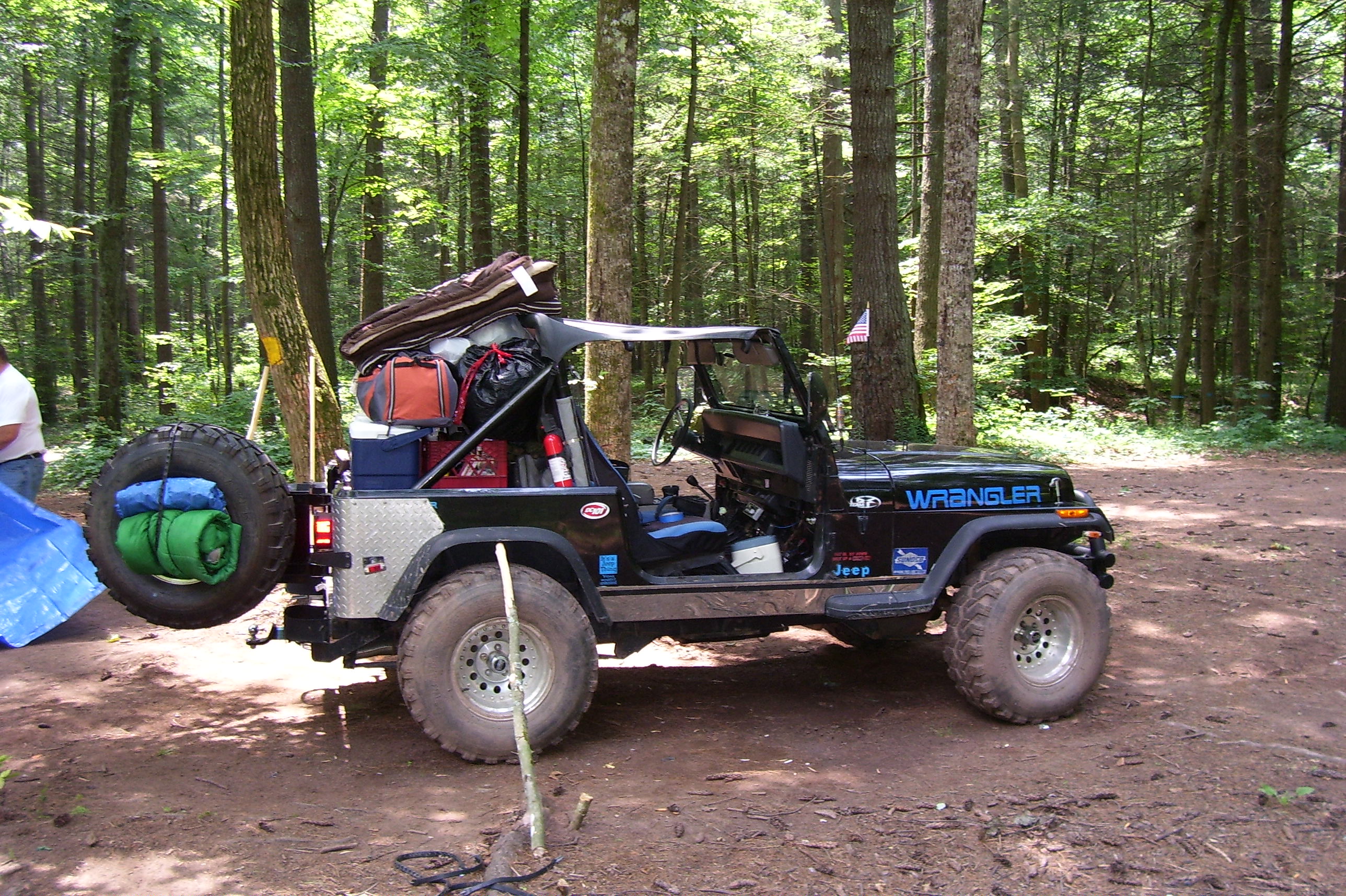

They make decent snow tires that will fit. You have to stay around 225/75r15, anything larger than 28" or 29" will rub in the rear.
You would need a 4" lift to clear 32" tires.
Thanks, but me jeep here I think has only a 3" lift and has 33x12.5 tires on it. it never rubbed. I may be wrong ,but just judge it by the pic.Tell me what you think. Thanks

i had 32 on mine with only 1" shackles and trimmed the fender flares. but i don't go off roading, either.

I ran 30" General Grabber ATs on my "95YJ with no lift. Great for snowplowing & light off roading. I never had any rubbing.
