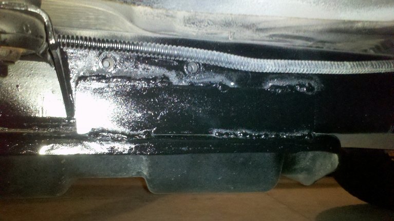

Welded a piece of scrap 3/16 strapping from the side of my frame to skid plate for extra security until I can afford to fix it right...

It looks fixed for now! When you get new the new piece, weld it over it.... Double protection.

Its the bottom of the frame rail that needs to be replaced.... I'm either going to get the safe t cap frame repair pieces or if it is still solid enough I'll weld in a new bottom? Not sure yet

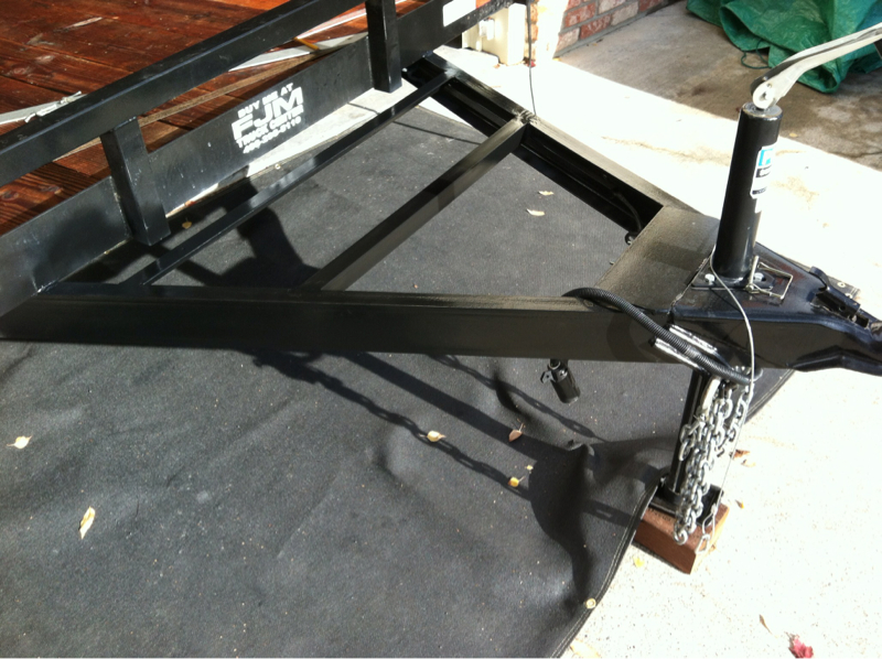

Bought a new box for the trailer. Need to weld a bar across the back to hold it up. This will make it much easier to attach the axle straps in front. The new box is perfect size for ratchet and axle straps.

Looking good. I have only one suggestion.... If you can afford it, buy your self a sheet of steel diamond plate and replace the wood on the trailer. I just spent $750 in materials alone to fix my trailer. The damn wood is holding moisture and the trailer will get all rusted and rotted out quick. There was almost nothing left of the frame because of it. I basically rebuilt it from scratch. Working on the sides and tail gate right now. I will post some pics of the way it looks now and all the rusted steel because of the wood. Just my two cents... A full sheet of 4' by 10' cost me $95 at my steel supplier. When the trailer will be finished, it will last me for the last of my life...

Productive day, welded some braces on the trailer for the new box and patched a couple of old holes from previous box. Usual bumps in the road. My brother mistakenly measured the second brace which sent me to Tractor Supply for some more angle iron. Then he dropped the second brace and I picked it up, only to realize he just cut that end with the plasma cutter. WOW, that hurts! Nice blisters on my thumb and middle finger. Everything turned out nice..

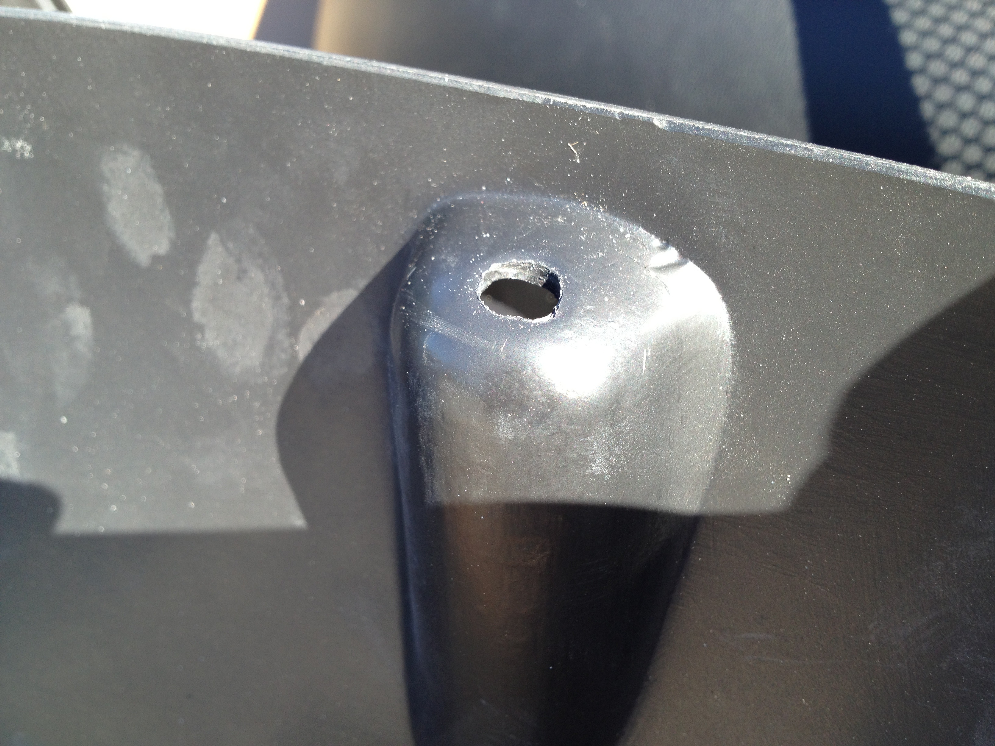

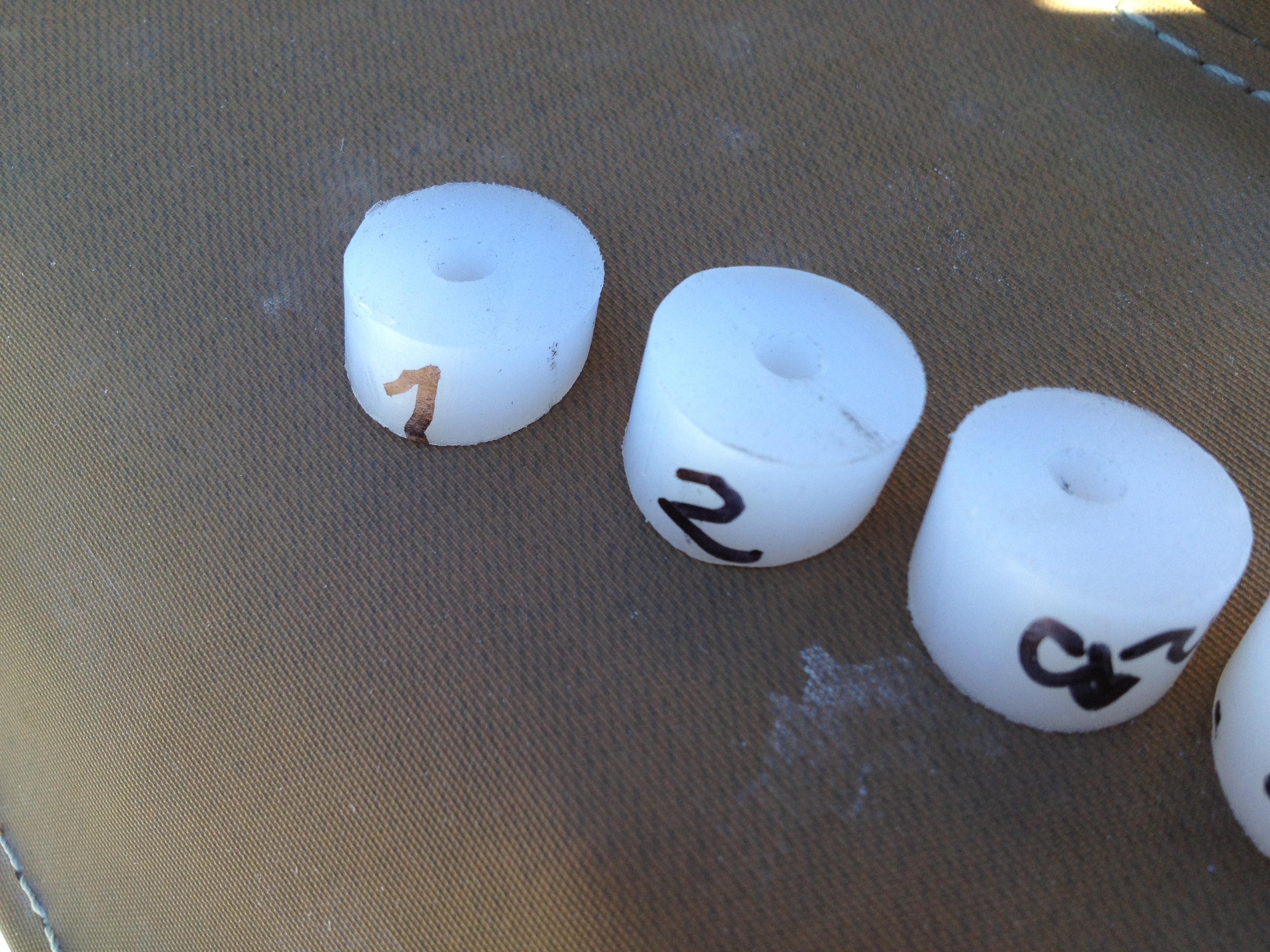

So I decided to finally replace my fender flares on YJ with the ones that I purchase 6 months ago.... The problem was that the new flares are poorly engineered or are meant to fail in a short period of time because there is approximately about 7/4 (it varies from hole to hole about 1/8") gap between the contact surface of the flare and the surface where the washer for the mounting screw rests upon. This means that if you torque the screws too much they will eventually crack and break of or you leave not tight enough and they will rattle. So I had to make some spacers that had to be custom thickness for each screw gap and they had to be one side flat and one at 18 degrees to match the flare. It was lots of work but the first flare is installed, screws tight as they can be and the flare is rock solid. I will post pictures soon to see the setup. Got I go and finish the rest.... Lunch is over
