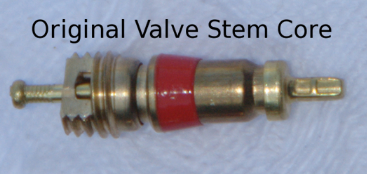

Likely the valve core is full of mud or other junk. The inside of the valve screws out, it's called the valve stem core. You can tighten it or screw it out, with a special little tool or sometimes you even find valve caps with a raised slotted end on them to tighten or remove the stem.
Most auto part places sell the stem cores separate from the whole valve. They don't cost much.
If you take the valve stem/core out the tire will go flat quick. If you let it go flat with the weight of the vehicle on the tire, there is a small chance the tire bead may pop off the rim.

Here is what the valve stem core looks like.

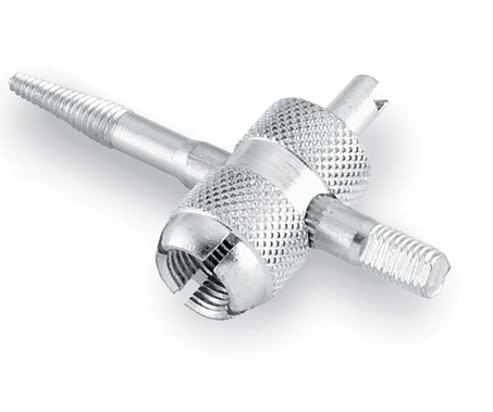

Here is the tool, the top part with the slotted end is the valve core removal part. There is also an inside thread cleaner for the valve and and outside thread cleaner. Darned if I know what the pointy end is for, maybe self defense LOL.
It's always best to keep the caps on the tire valves. Always buy a few extra caps, stems, valve cores and a tool to keep in the glove box. Cheep insurance.

hey MudderChuck, the pointy end of the valve stem tool is to screw down inside a wrung off valve core, the threads are reversed so you screw it down in the direction that you would turn out the core. When it seats all the way down and you are very lucky it then continues to turn bringing the core out with it. As for tire sizes the early(87,88 etc) XJ's actually came stock with 215's. I run 235's sometimes but have discovered that I get better fuel mileage with the 215's.
Thanx for the info, figured somebody knew what it was for, I just knew it wasn't me. Never too old to learn something new. Thanx again.
