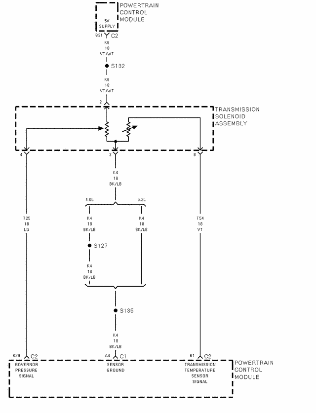

Check for a 5volt supply between the PCM and the Trans. solenoid assembly. Also make sure that the fuse #17 on the PDC is getting a full battery voltage out to the solenoid pack.

I tested every contact point in the wire harness while connected to the TCM. I tested DC volts from the contact point to ground. Here's a diagram of the readings I got. #4 connector to throttle position is 1V, increases to about 4 when I press the gas pedal.
To reiterate: 42re auto trans, 1994 4L inline6, no trouble codes for engine or trans. OD/Off switch turns light off and on with key on/engine not running, but light stays on, no OD, when running. (Sometimes it will work for 5 minutes, about once a month, for no reason.)
