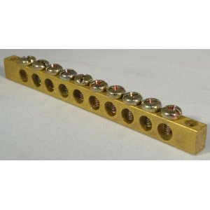

I know that on the old CJ's AMC grounded the headinghts to the fender. I this wondferful PacNW climate I ultimately went with a ground bus bar and ran all of my grounds to it, and ran a 6 ga. wire from it to the negative battery terminal of my secondary battery.
