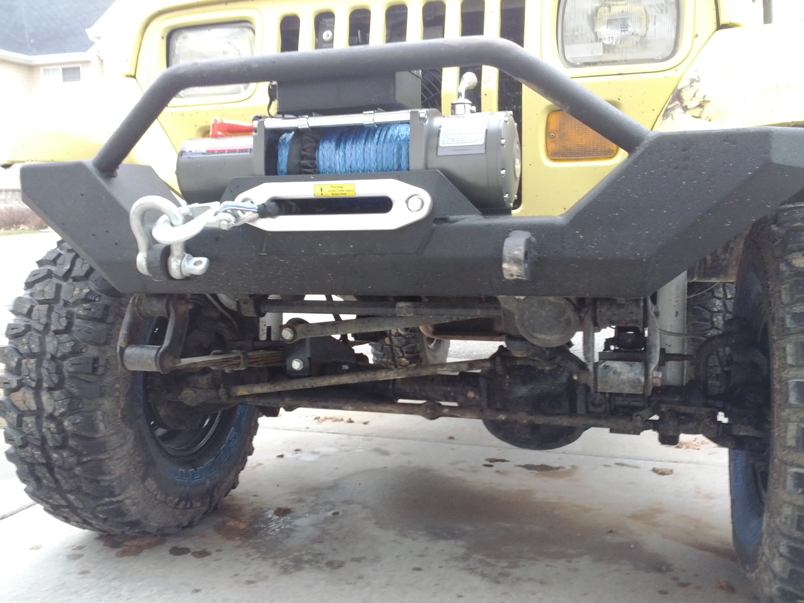

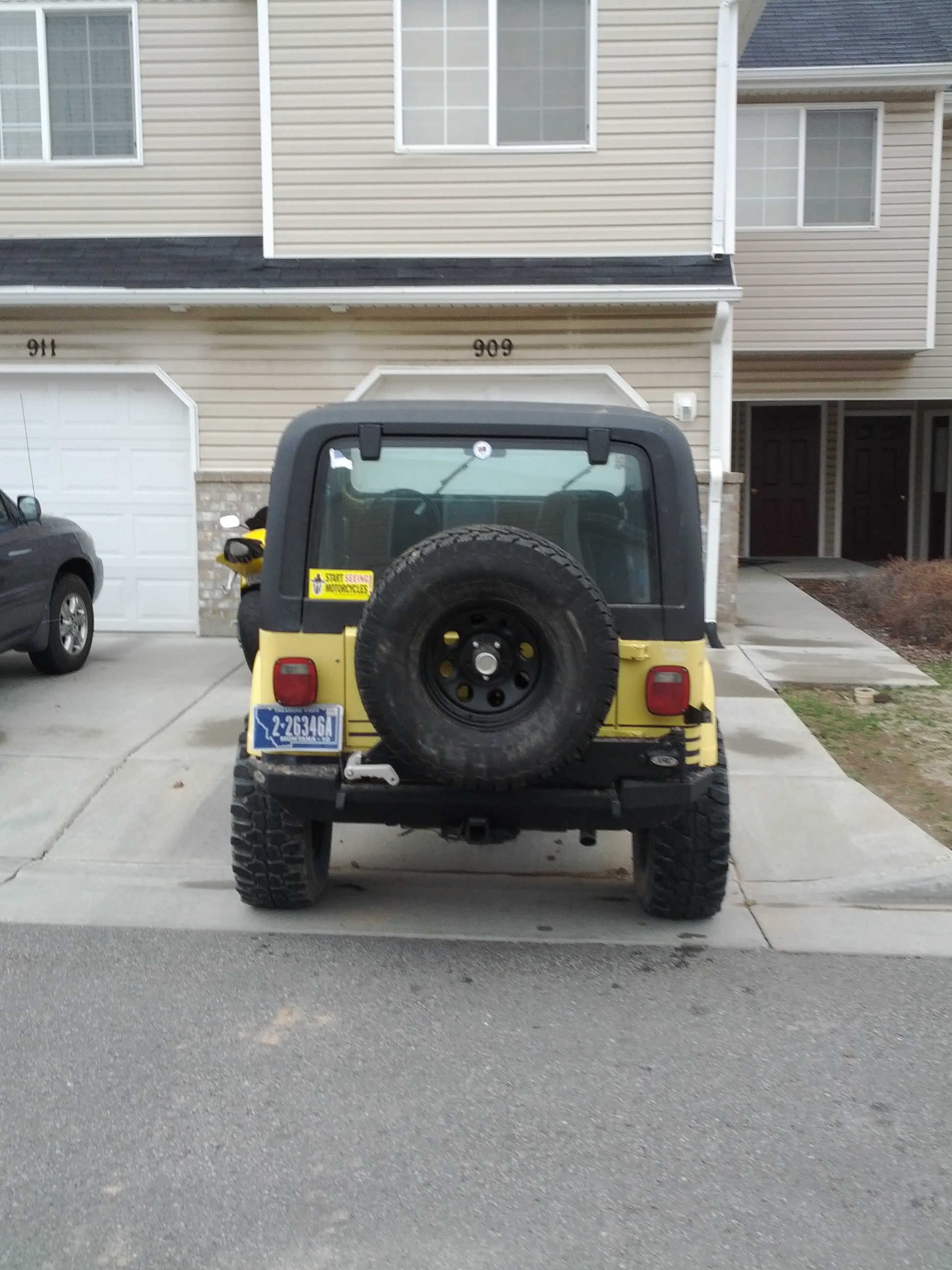

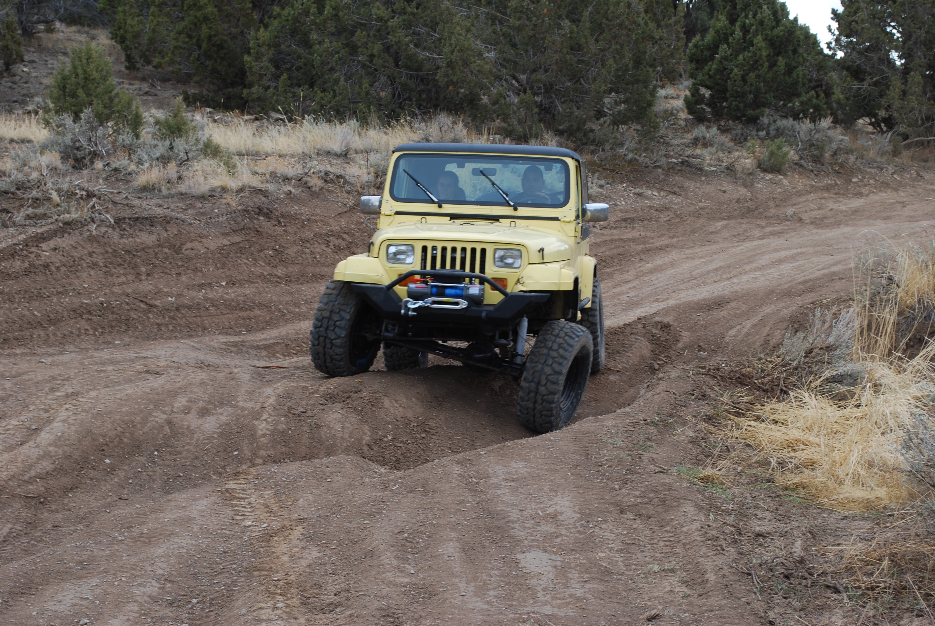

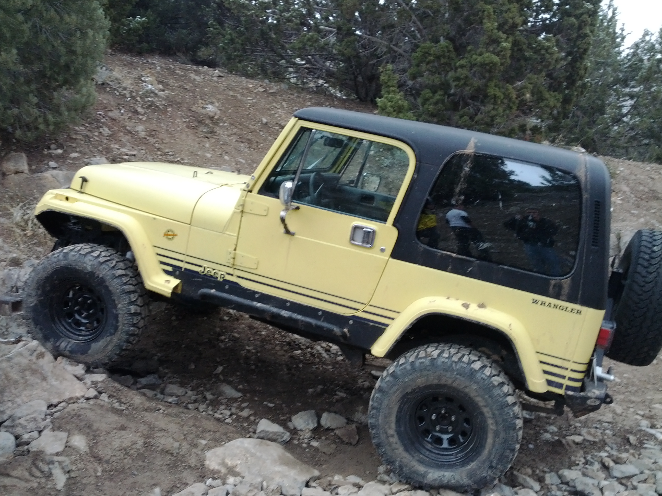

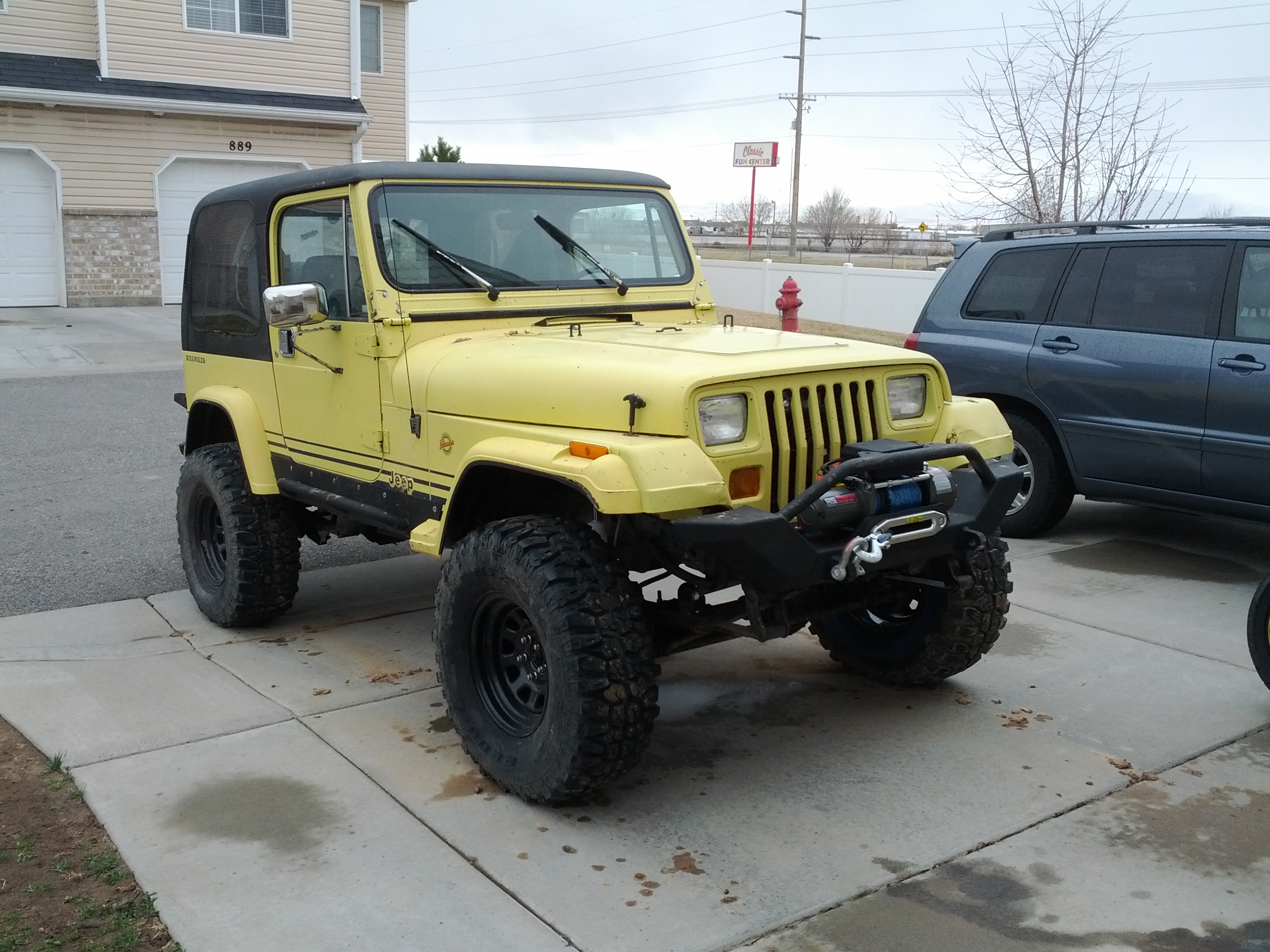

ok got a big portion of the build done finally...
SOA lift
XRC front and rear bumper with tire carrier
rock sliders
33in tires
8.8 rear
rough country winch
electric fan
headlight rewire and upgrade
duplicolor bed liner on the interior
SYE and new shaft
