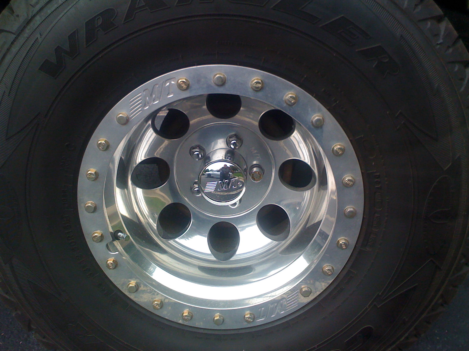

Has anybody tried to paint there chrome wheels, or have them powder coated. I have chrome M/T's and as a winter project want the redone in black. Is it as easy as proper sanding and shaky can? I'll appreciate any and all info you guys could give me.

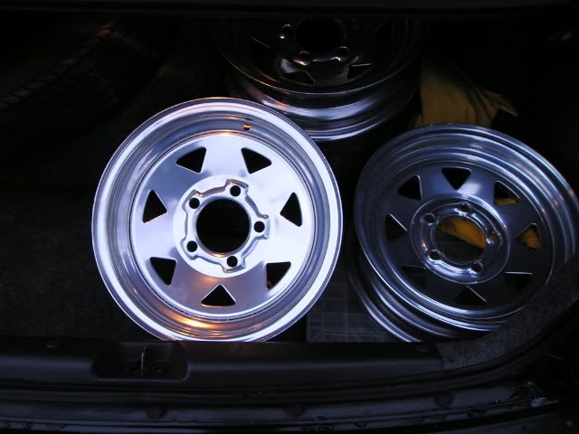

I did these a few weeks ago .
and used this to do it.
final out come on vehicle

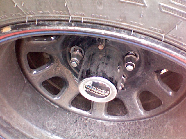

I just want them matte black, I am going to take the beadlock bolts out first.
I used a wire wheel, they had surface corrosion on them . Then i wet sanded them with 320 than a green scuffy and painted them.

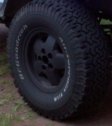

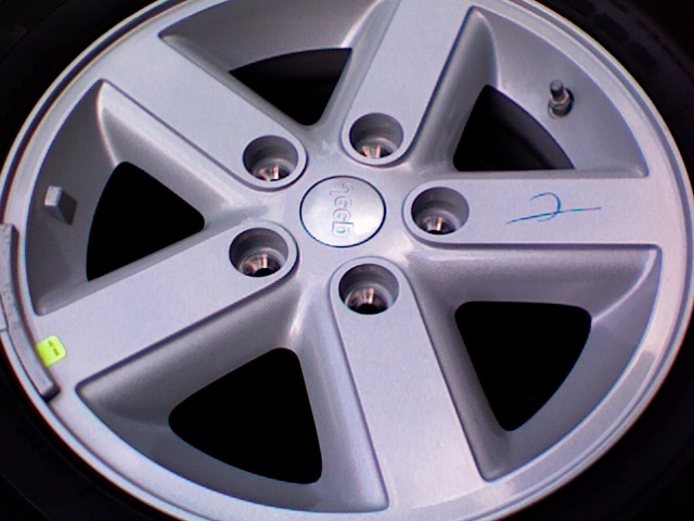

Do you think i should rough these up before i paint them??? They look so smooth i would just feel bad. i want to go gloss black in the background and flat black on the 5 spoke section.

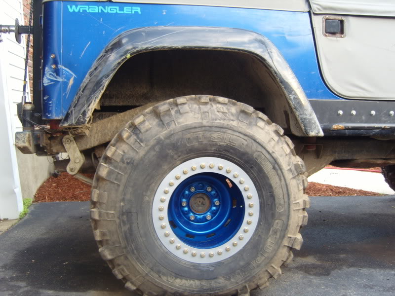

jps4jp, I run those same wheels with Q78's, minus the beadlocks. I put the beadlocks on some SJ 15x6" so I'd end up with 7" wheels.

I had so many problems with the 8" rims and no bead locks with the Q's. I could not go below 6 spi or I would be blowing beads all day long, I ended up trashing those wheels bad from driving with no tires over obsticles to a flatter area just to change a tire.
With the bead locks, I can get down to 3 psi no problem. In the spring, I am gonna cut these tires so I might only have to go to 4 or 5 psi, keep a little ground clearence and still get the performance out of the tire.

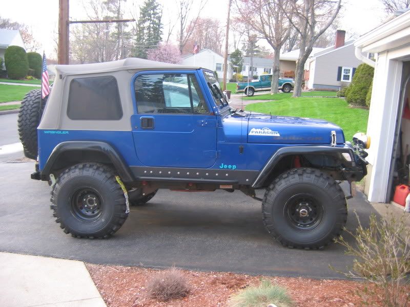

What beadlock kit did you use? Are you happy with the final ~9" rim width?
