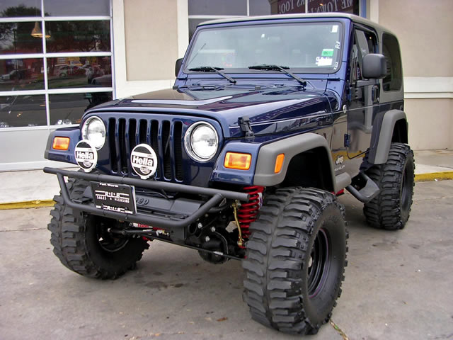

This is what I want my jeep to look like. NOTE: It's not mine!

First off welcome to the "Z"...
As to where you want to go and what you have is a lot of wrenching, cutting and welding.
As to lift kits everyone has there favorite, but after 4 inches of lift I recommend one that is a long arm type with beefy joints, heim or Johnny joints. Personally I run a Tera-Flex lift and so far after 8 years have had no complaints. But then again that is my personal opinion. On my web page you can see several of my friends and there jeeps, we have a fab-tec lifted 2000 white TJ, a RockCralwer1997 blue TJ and green ZJ and a Rubicon express 95 white XJ. But all of them have gone to a long arm like mine, they say the ride is so much smoother.
Since no manufacture has a 'all in one' lift kit, your going to be buying pieces from several companies.
