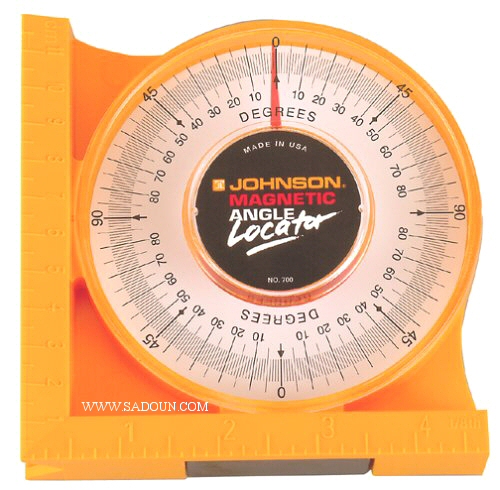

No special tools. You may want to get an angle finder, the kind with two magnetic sides. This will help confirm the angle of the pinion and driveshaft, instead of just eyeballing it. Available at most hardware and farm stores.

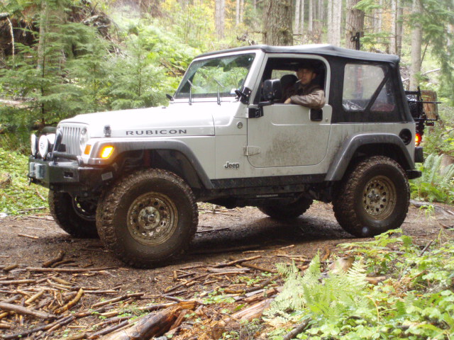

So freebird, basically you've got a 4" short arm with new upper/lowers and adjustable track bars? Did you do the t case lowering kit or did you do the new longer rear cv driveshaft? I had to cut the floor so the shifter would reach R after I put in the t case lowering bracket and I should have just spent the extra money for the driveshaft and left the t case where it is. Did your shifter bump as well?
Nice jeep man, I did get the longer CV driveshaft 16.5 Rubi Express. I would of probably got the tom woods if I known earlier.
